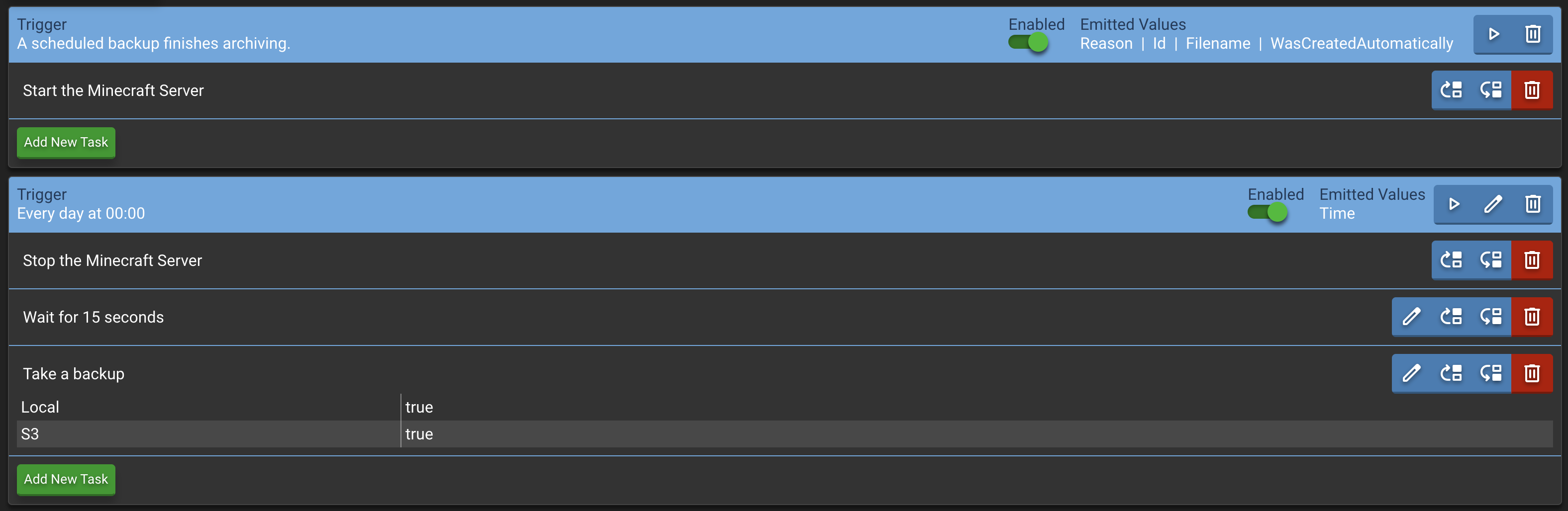

The Shut the server down, take a backup, and start it up again task would be blocking in all three of it’s “stages”, so to get things working a bit quicker you’d have to split things up a bit.
Not 100% sure if this will work, but here’s an idea:
Trigger 1 (timed trigger):
  • Stop Server
  • Wait 60 (in case the server takes a bit)
  • Take a Backup (with S3 enabled)
Trigger 2 (When a scheduled backup finishes archiving):
  • Start server
I think it should fire that event once the backup zip is “done”, but before it starts uploading to S3, allowing the server to start while that’s going on.
That’s a great idea! I just gave it a try, and unfortunately it doesn’t appear to work. It runs the “A scheduled backup finishes archiving” trigger after the S3 backup is done. Here is a screenshot of the schedules I set it.
