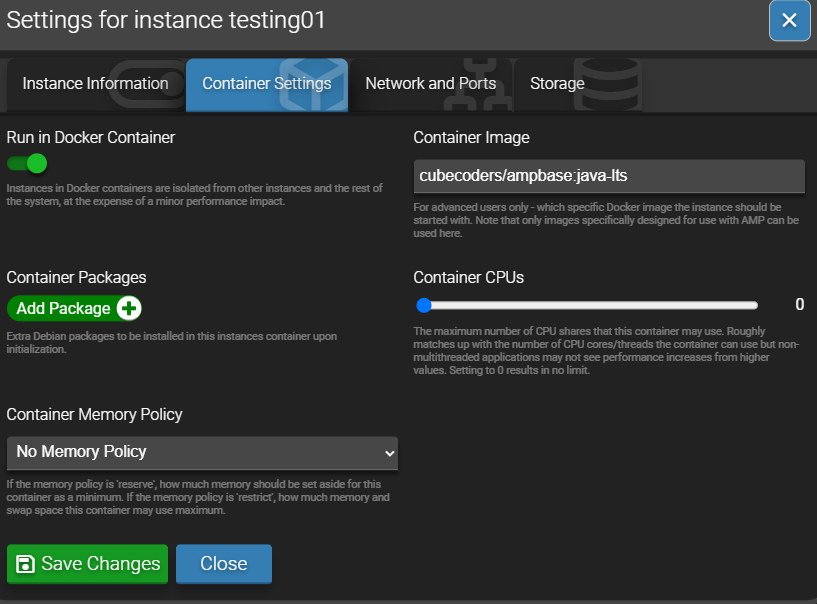

Click on the pencil icon on the instance tile and change the image to cubecoders/ampbase:java-lts
I stopped the instance, clicked pencil , and tried typing cubecoders/ampbase:java-lts in as the image (this was not one of the dropdown options), saved changed, started the instance, and Java 25 still did not show.
I repeated this, instead choosing cubecoders/ampbase:java from the dropdown. This didn’t work either.
I also tried both the above with a newly created test instance, and that didn’t work.

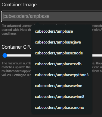

java-lts does not appear in the dropdown menu.
I know, it hasn’t yet been integrated into AMP’s code (I don’t have access to that code)
Type it in

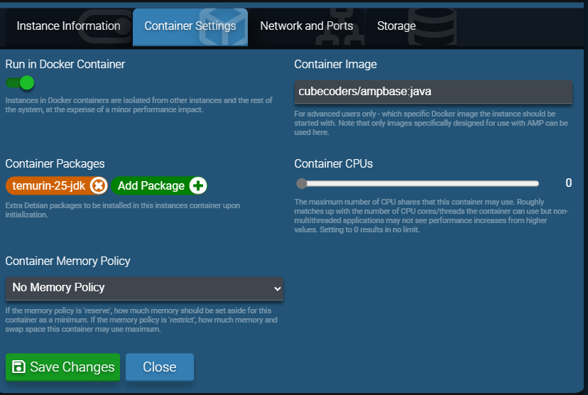

To add java 25 you should:
in Container settings - Container Packages press Add Package
type temurin-25-jdk
restart the instance

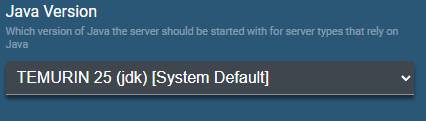

after that, you will be able to choose java 25 in minecraft settings
The right way is the way I posted originally, so that Java 25 does not have to be reinstalled every time the instance is started
Change the docker image to:

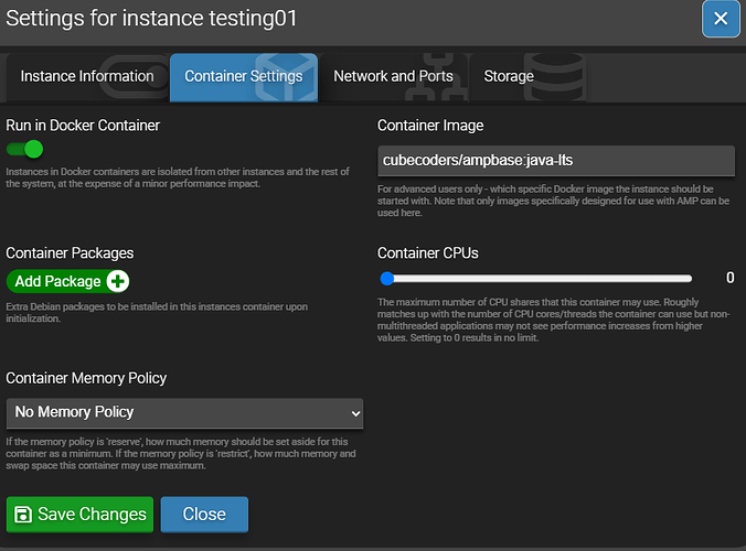

Sadly, neither works. I have tried both (and also adding the package and putting the lts image in container image).
My java -version shows:
Is docker even enabled for that instance?
Did you save changes?
What shows in the deployment log?
Yes, changes saved:
