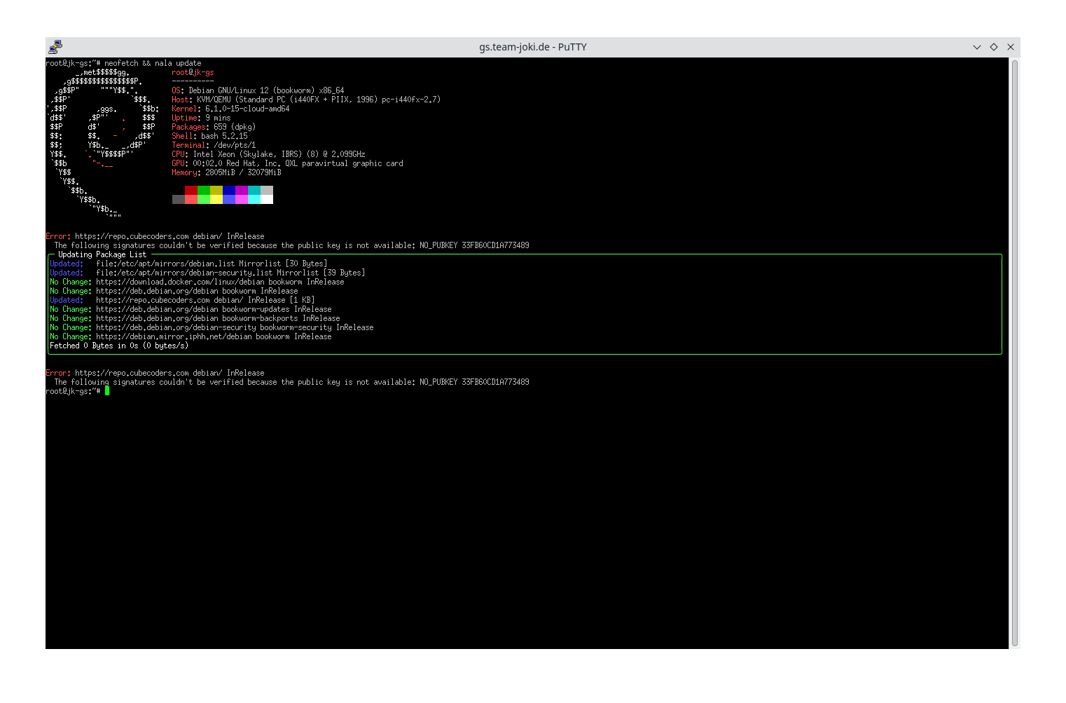

So actually I’ve got the same problem with that key. I already updated it
wget -O /usr/share/keyrings/repo.cubecoders.com.gpg https://repo.cubecoders.com/archive.key
But unfortunally this error still exists. Since I’m on a supported version of Debian that error shouldn’t exist, so hopefully somebody knows an answer that will get this repo working again.
getamp addRepo did the thing and problem solved
