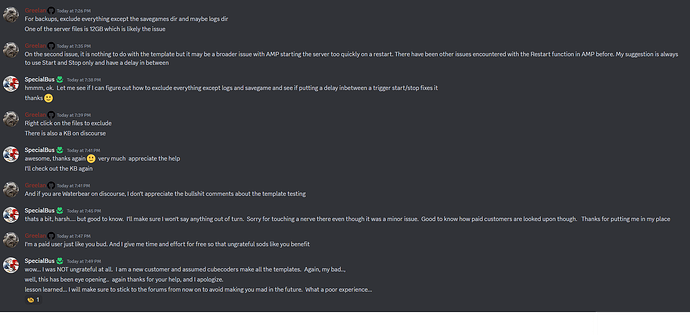

Greenlan - you really need to chill out. I did not dump on you AT ALL. I’ve got the screenshots if you want to keep acting like a child… This forum post was never an attack on you personally but you decided to make it so… lets me sure everyone knows whose being rude here… get some help bud. I wish you well and hope you have a better day…
No, your comment was directly a comment about the quality of the template, which means you are criticising the creator of the template. The issues you have raised have nothing to do with the template - they would equally affect an “official” server module.
I made that comment about cubecoders rubber stamping templates. I did not insult you directly and being new to AMP, I had no idea cubecoders wasnt involved in templates available in their own software… as end users we have NO IDEA if issues are on AMP side or template side. You took everything way out of context as if I was personally attacking you. And all I said was it was a ‘shame’ about the bugs we all are experiencing with templates and perceived QA by the company (again not YOU). Again, I apologize just like I did so immediately in the screenshot, but then you call me a sod and whatnot. I’m done buddy. No point in continuing the conversation.
