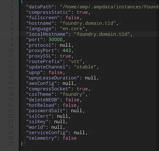

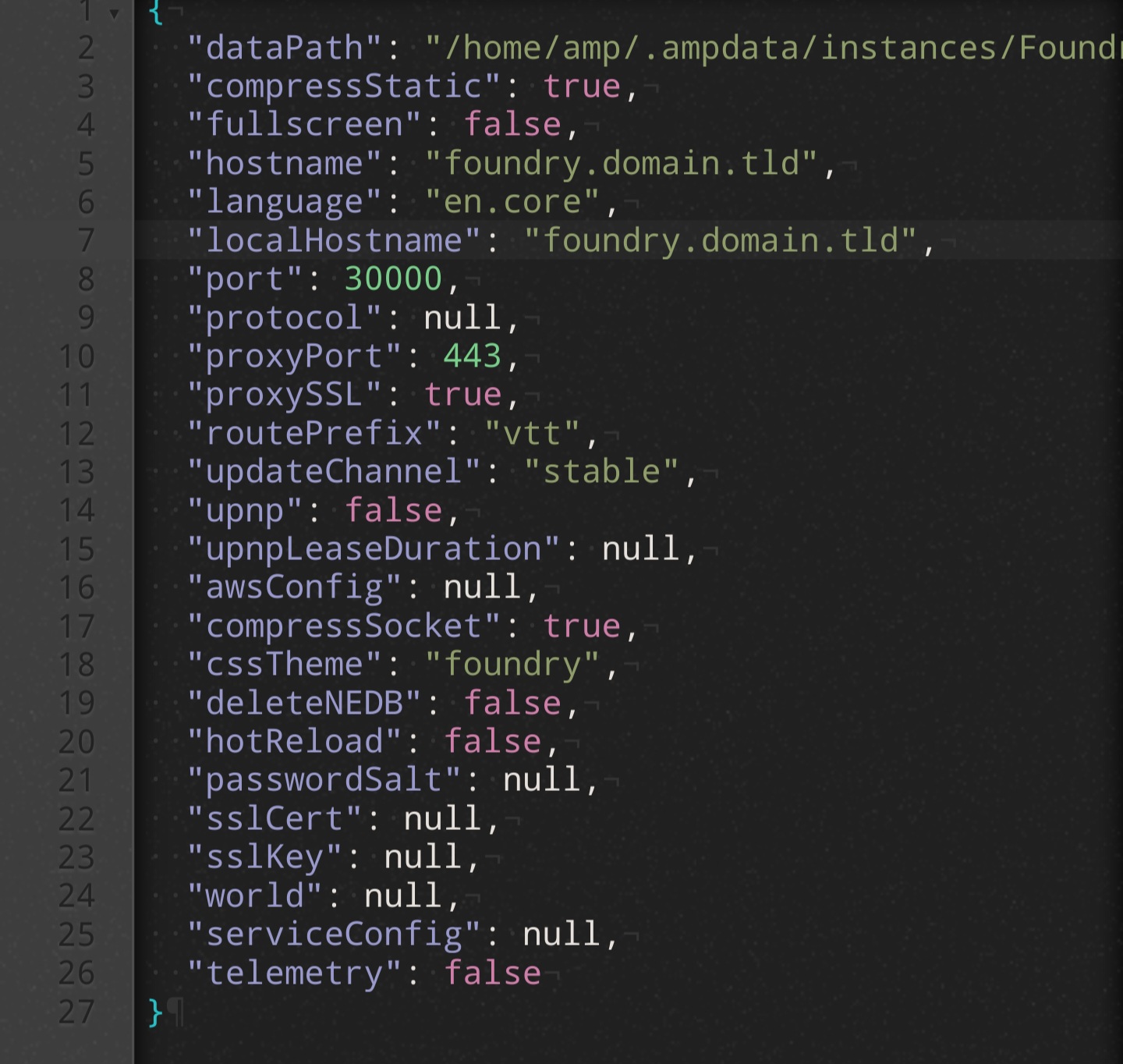

I couldn’t reply or edit. But everything in AMP and my reverse proxy were fine. The issue ended up being the options.json
After I added the hostname, localhostname, and the route prefix, it segregated the player links from the hosts admin link. I was able to use a natural domain over SSL without players using a port either.
