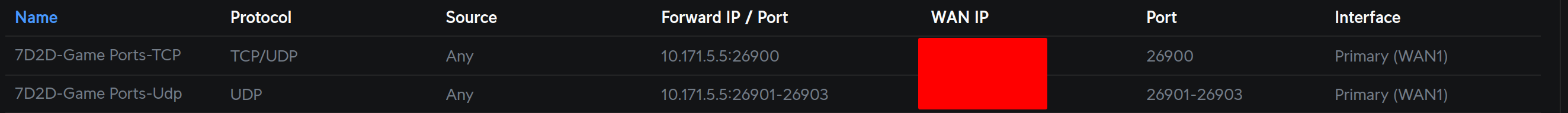

Show your port forwarding rules
of course the x.x.x.x is to block out ip.
App Protocol Remote Port Dest External IP Local Port Interface
7D2D-Game Ports-TCP TCP/UDP Any 10.171.5.5:26900 x.x.x.x 26900 Primary (WAN1)
7D2D-Game Ports-Udp UDP Any 10.171.5.5:26901-26902 x.x.x.x 26901-26902 Primary (WAN1)
You are missing a forward. You need to forward at least:
26900 TCP/UDP (Server and Steam Port)
26901-26903 UDP (Server Port +1, +2, +3)
Assuming the default ports are allocated in AMP - adapt as needed
Also the external IP should be empty - by putting a value there you’re limiting it to connections only from that IP.
@Greelan When you say “Assuming the default ports are allocated in AMP” you are talking about the listening ports in the instance.
@Mike Yes Mike, in the instance is says 0.0.0.0:26900.I will assume that is what you are talking about
I’m talking about your port forwarding rules. I’m pretty sure you’ve unintentionally set it up so anyone can connect. Show us a screenshot of the Unifi settings, censoring out your external IP only.
Here you go
Okay that all looks fine - did you check what I said earlier whether a different device on the same network can connect using your Internal IP?
