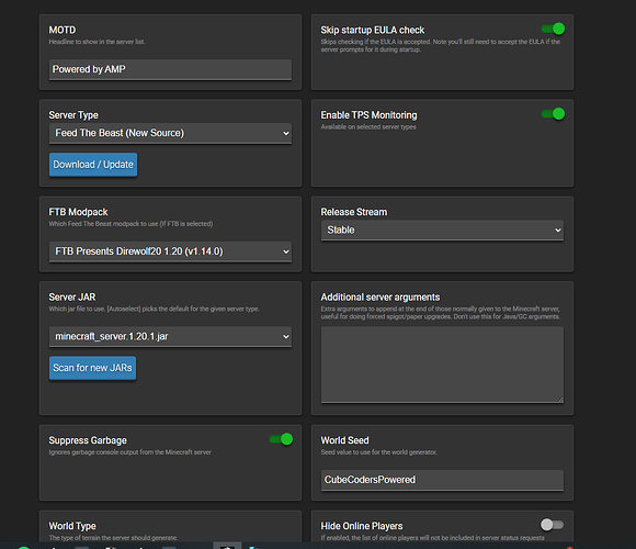

I tried selecting the right modpack and version in the configuration tab

That’s the wrong server jar, leave it as Autoselect
and select the right NeoForge version for the pack
NeoForge 1.20.1 also needs Java 17 to run
I was trying to do the direwolf20 1.20 pack, what about the server installer? I dont know where to install it to
Select the pack and download it in AMP, then once it’s done select the right modloader.
If you don’t select a modloader the server will start as vanilla.

AMP doesn’t use a run.bat
, which is why you need to manually select the modloader and version (which should be listed either on their site or in your launcher).
Again. If you do not select the NeoForge version the modpack uses, it will not start correctly.
After downloading the modpack in AMP you need to change the server type to NeoForge, then select the NeoForge version
