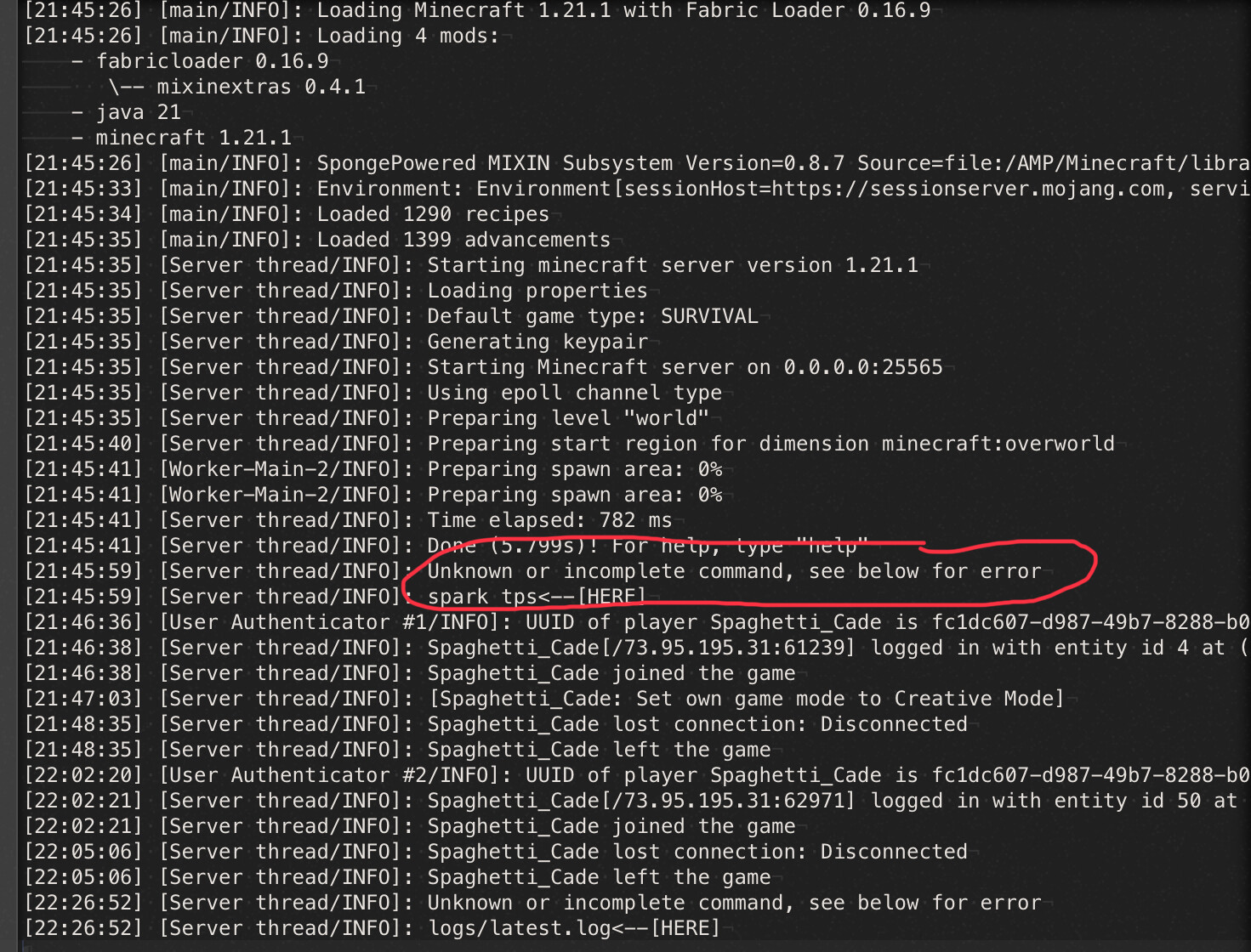

Check the logs/latest.log for any errors regarding loading Jars, and make sure that the server is starting with Fabric in the log
Fabric does appear to be in the log but I found a different error in there.
That’s fine to ignore
Looks like there’s just no mods loading.
Ah, your mods are not in the right directory.
They need to be inside the mods folder, not inside an inner-folder
Oh. I can’t have a different folder inside the mods folder? I guess that makes sense. Let me reorganize and see if that works.
Edit: Yep, that was the problem. Note to future self, don’t just import the curseforge modpack to make the server. Only take the mods folder from the pack. Thanks for the help!
