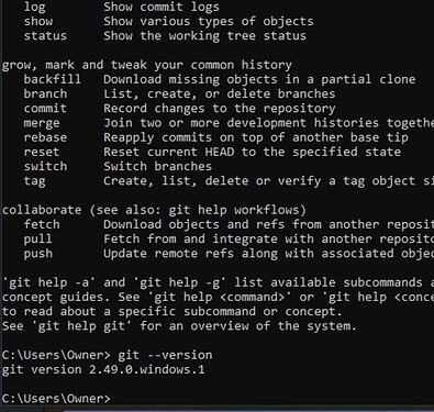

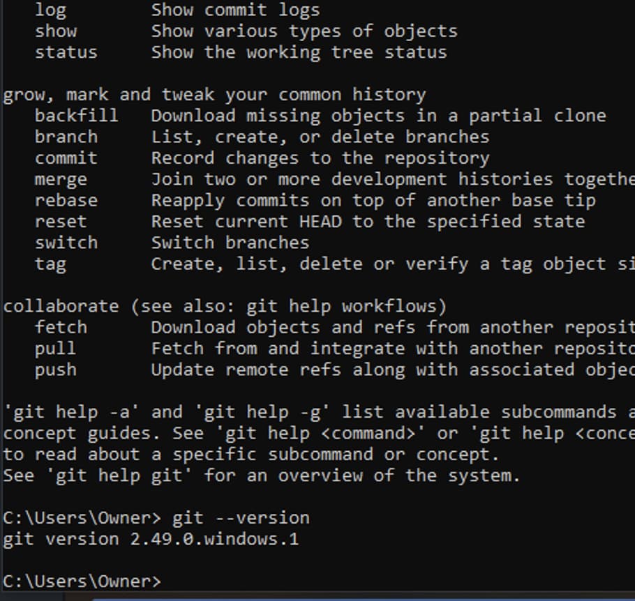

Does your system have Git installed and in the PATH for all users? It’s needed to reliably get template repo updates
That’s what I’ve been thinking, just didn’t know how to fix it. The amp installer “automatically installed” git, but I will run a quick test and see if its working correctly
thank you for your continued help with this
Git does seem to be functioning via command prompt

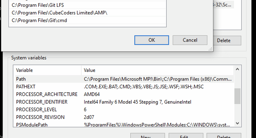

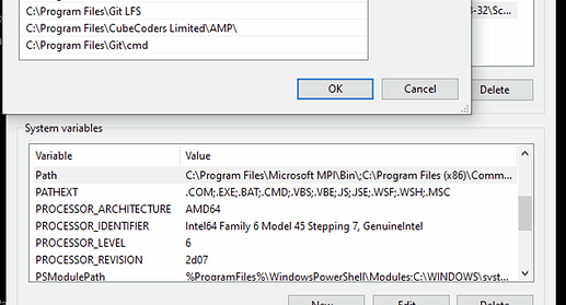

Needs to be in the System PATH so that Network Service - what AMP runs instances as - has access to it
It does appear to be set up as system path

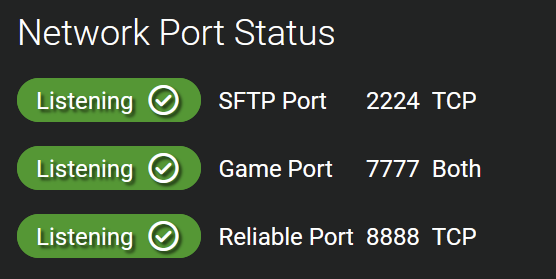

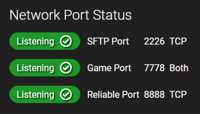

Alright, new instance is up and running, port 8888 does show up correctly in instance manager, :grinning_face:
and I got the save loaded, everything seems to be all good, Thanks for your help in tracking this down
