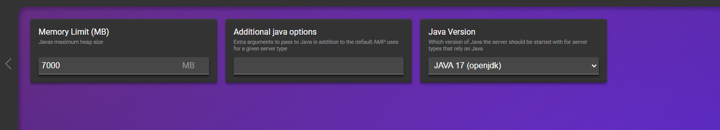

can i ask you to go to Configuration > Java and Memory and tell me what it says in Java Version

your computer being on windows doesn’t matter. Amp is running linux from the openjdk i see. Now i don’t know why its not working but i would say wait for ThePotatoKing to see this and they can help you out cause im trying everything the same on my end and i don’t get that error myself
