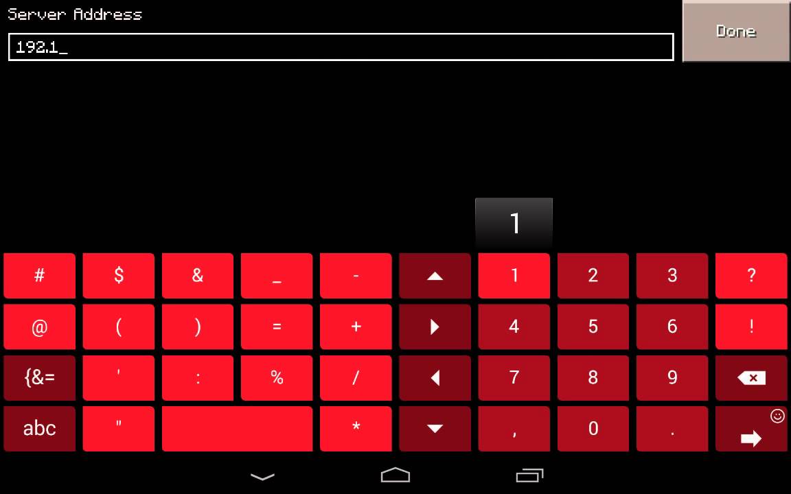

I don’t have any tablets, but this video:
shows about making the server connection and I see a box for local server.
Also per this:
https://gamewiki.blog/join-minecraft-server-on-tablet
you might make sure they are both running bedrock. I assume from the post you did, but checking.
I did indeed add the server as shown in the video. It worked fine on my son’s PC, but failed on the laptop and tablets. This is the issue I’m trying to figure out. Why it works on one device but not on others when all devices were set up the same way. It’s driving me crazy(crazier).
