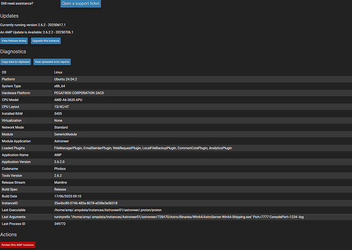

That can be ignored. Can you show the Support and Updates tab for the instance, specifically the executable and arguments at the bottom?
Heres the page
Looks good. Did you make any changes to the client?
No its just the normal base game from steam
