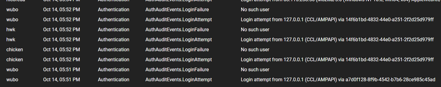

There’s a botnet spamming SSH/SFTP at the moment.
Block 188.190.10.x in your firewall (eg if you use ufw: ufw insert 1 deny from 188.190.10.0/24)
Then restart the ADS instance from the command line to clear the rate limit:
ampinstmgr restart ADS01
I’ve tried that. Got feedback that the rule updated, restarted the instance, but same behavior returned less than 5 minutes later.
yeah same thing here and I have no idea where it’s from. It’s always thoses sames, and I have no clue what’s their IP to be able to block them.
Some users are having trouble adding firewall rules to their setups for whatever reason, doesn’t seem to be related to AMP, as I’ve been able to do it fine on multiple Ubuntu/Debian installs
The IPs are logged inside the instances, it’s the same set of IPs attacking everyone.
Thanks for the message I found them and they correspond to the ones you said thank you!
Yeah, once there’s a fix in place the IP logging should line up
I set up fail2ban to automatically ban those spamming ip adresses.
If youre interrested in using fail2ban, here is my configuration:
