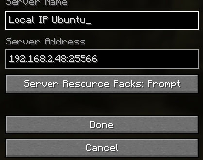

I know its best practice to use my local IP for LAN connection but unfortunately that doesn’t work either and i just time out. I’ve noticed when i connect using my local IP in the console it still shows "(/Public IP:56071) lost connection: Timed out " and even with my public ip it shows the same thing. If i turn off my port forwarding rule from my router it does let me connect with the local IP.

Yes that is correct, if i port forward my friend can connect but it then blocks me from connecting via local or public ip. Also a weird thing is when I’ve port forwarded and try and connect via my Local IP the console shows my public IP
Can you screenshot what you’re using to connect that gets switched to your public IP?

If im connecting to the server with my port forward rule set to “ON” then instead of my local IP showing in amps console it will show my public ip instead
Interesting… It’s definitely something either misconfigured or a software flaw with your router. What model is the router specifically?
