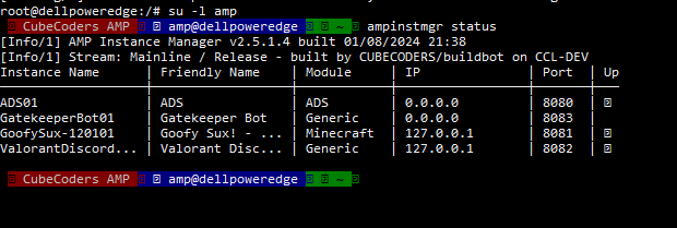

I’m running into an issue where I cannot connect to the AMP web server through my external IP. I have checked everything to make sure that my ports are forwarded correctly and that my machine isn’t blocking the request.
I can connect to the web server through a internal ip, but when I try to connect to it through my external IP, it doesn’t load. However, the minecraft server that I’m running can be connected to through the external IP so I know my ISP port forwards are working. I also checked the canyouseeme.org results to ensure the default web server port of 8080 is forwarded as well. I also checked all of my firewall rules and my configs for AMP that I configured through the internal ip access.
- Start AMP and connect to it through internal IP address at port 8080. This works fine.
- Try to connect to external ip at port 8080. This does not work.
- Checked port forwards to ensure it is set up properly. This is complete and I have checked multiple times through different means.
