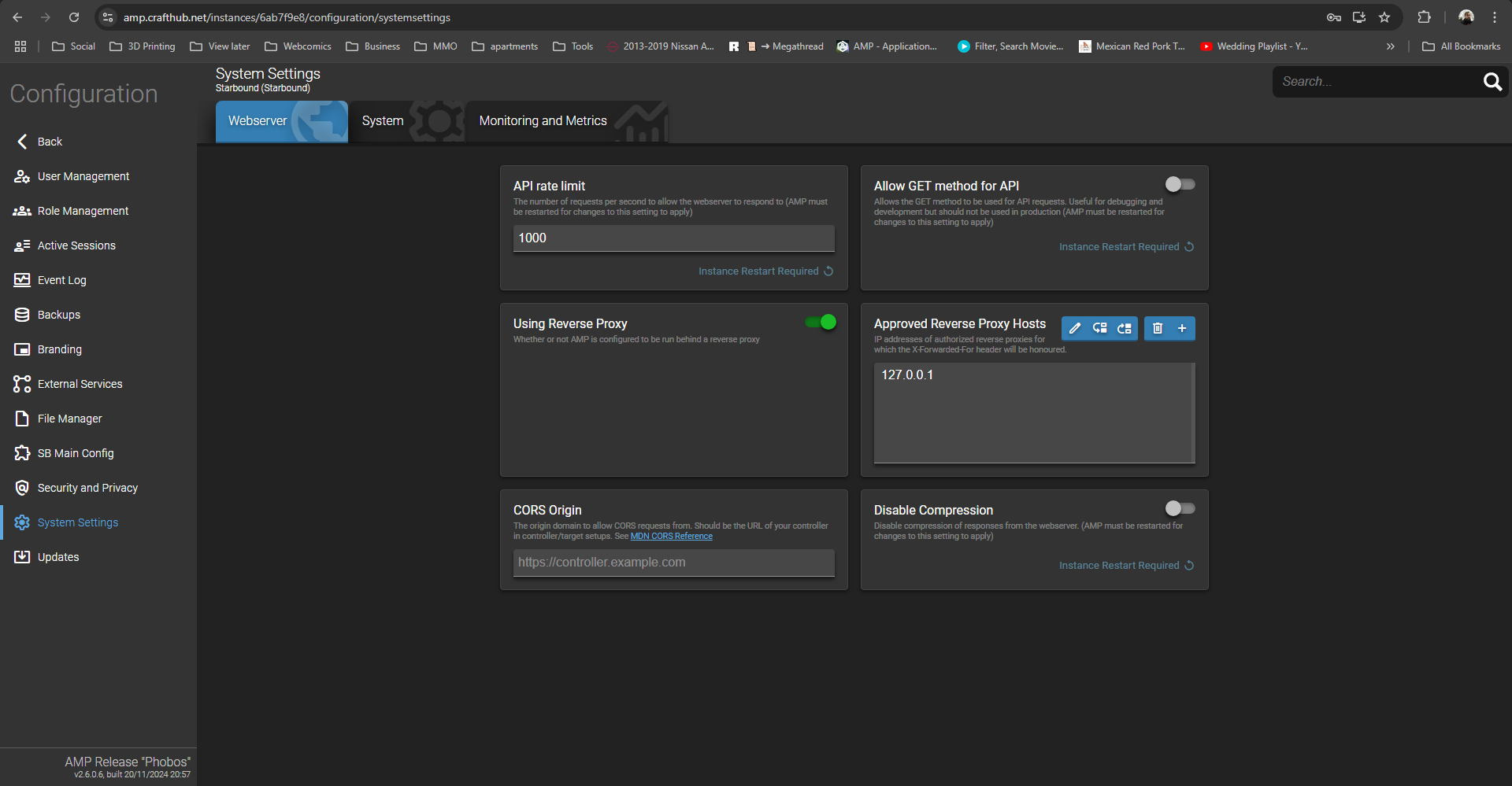

Gotcha. I just meant that Starbound doesn’t even offer Sleep Mode in the config anywhere.
It does. It is in the same spot (System Settings>Sleep)
I’m not seeing it on my instance. Picture attached.
edit: … though a new one I made just now -does- have it. That’s bizarre.
