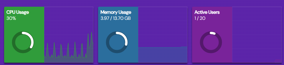

The amount of allocated ram that I set never seems to be the real ammount that the server is using. Its only using arround 3-4 gb of ram even when i set it in the 8-14 range where I had set it and want it. I know this because on the status page it never goes past that, and using an external mod that lets me check the ammount of ram its currently using in a command, it reads xMB / 3104MB.
  • Set the allocated ram in configurations → Minecraft
  • Start up server
  • Server Claims to have that amount set, but it doesn’t go anywhere past 3-4 gb

How would I increase that then if its possible, because when the server needs more ram in entity heavy situations it still caps out up there no matter what, and the server can never use the memory. It was working like that before where it was actually using all the ram, but a few restarts ago it stopped. The server is even going down to 15tps with only one person in a village and I’m planning on opening the server to a large group of friends

I am just concerned because before it was able to use all the ram allocated and now it’s using barley what it was, and I’m ok with the tps since its obvious with all the entities I’m loading as a test.
Chunks are set to 6 chunks with sim distance set to 4, and using server core the mobcap is at 60%

Ok so nevermind nothing is fixed, memory is constantly being over loaded and i have no idea what is caping it still. And Ik I’m not crazy because it was working 2 days ago perfectly fine where it used the right amount of memory and the tps wasn’t 15 with only 1 person and now its 7 with 3 T_T
Ima need some help if someone has experienced maybe any mods I’ve missed by accident that others know could be the cause
