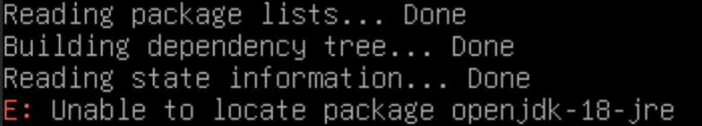

This is what I get when I input the code you previously provided.
Maybe try that with a sudo apt update then sudo apt install openjdk-18-jre
Sometimes packages need a refresh before they can be downloaded.
If that still doesn’t work there may be an extra repository that I’m forgetting about
Maybe try temurin-18-jre. Not sure if that Version is available but temurin is what AMP installs for you
I looked up what’s in the repo. You need to run apt install temurin-18-jdk to get Java 18
And for future reference, you can lookup which packages are available with apt search temurin*
Whoopsie on my part, thought that package was available by default
