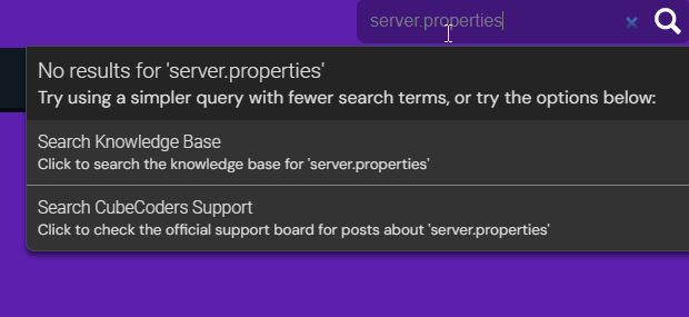

i’m a special snowflake, so i don’t get how i’m supposed to change it using the web interface. after i go configuration idk what to do lol
You look for the setting, which is probably under Gameplay or something similar.
With the search bar, again, you can use it to search for the setting you’re looking for. (the setting you already know the name of)

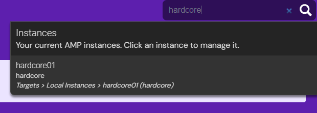

Search “hardcore”, the setting you’re looking for
i get the name of the server, which i made as “hardcore” nothing else
You need to manage the minecraft server instance first, game-specific settings aren’t in the main panel.
jesus christ it finally popped up ty so much. im braindead. appreciate it
