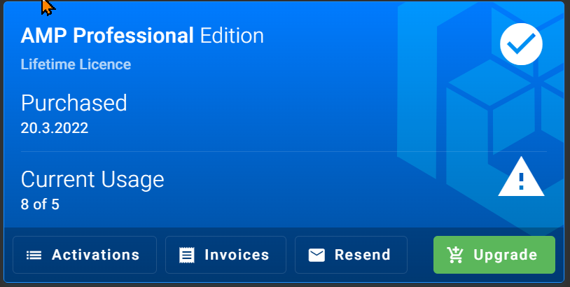

Why does it say 8 of 5? (Only running one server!)

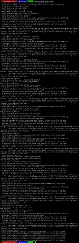

But running the update of AMP I get these errors:

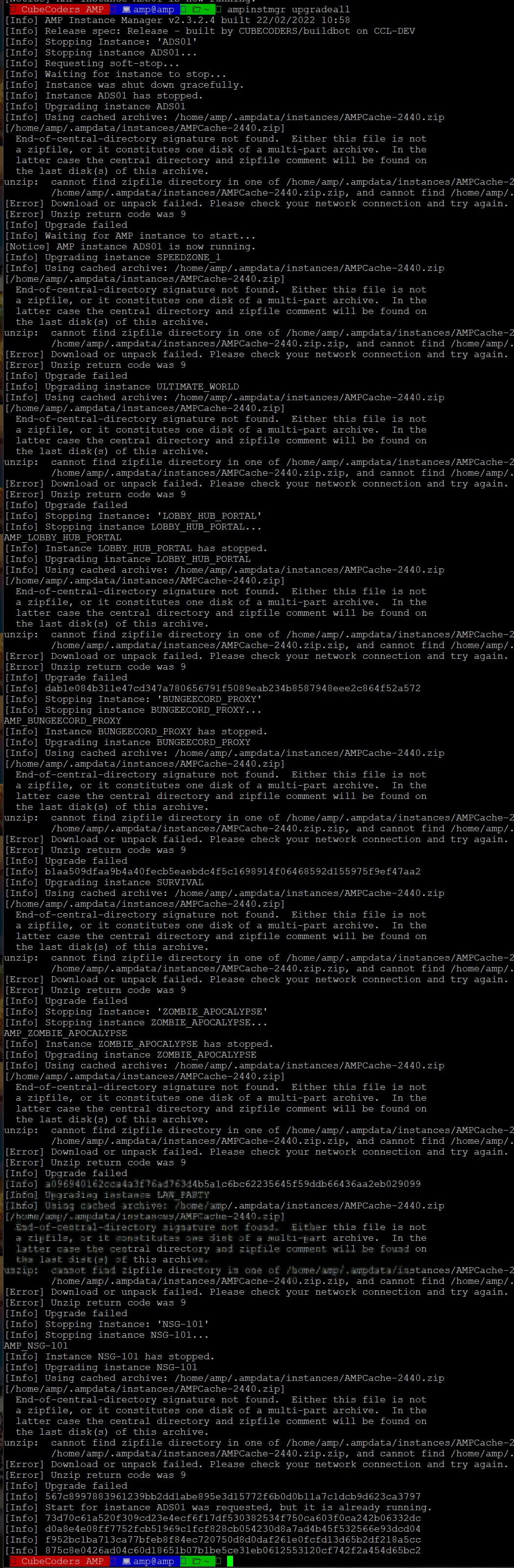

I tried the:
ampinstmgr --nocache upgradeall
But even after download it dosent upgrade through the terminal.
