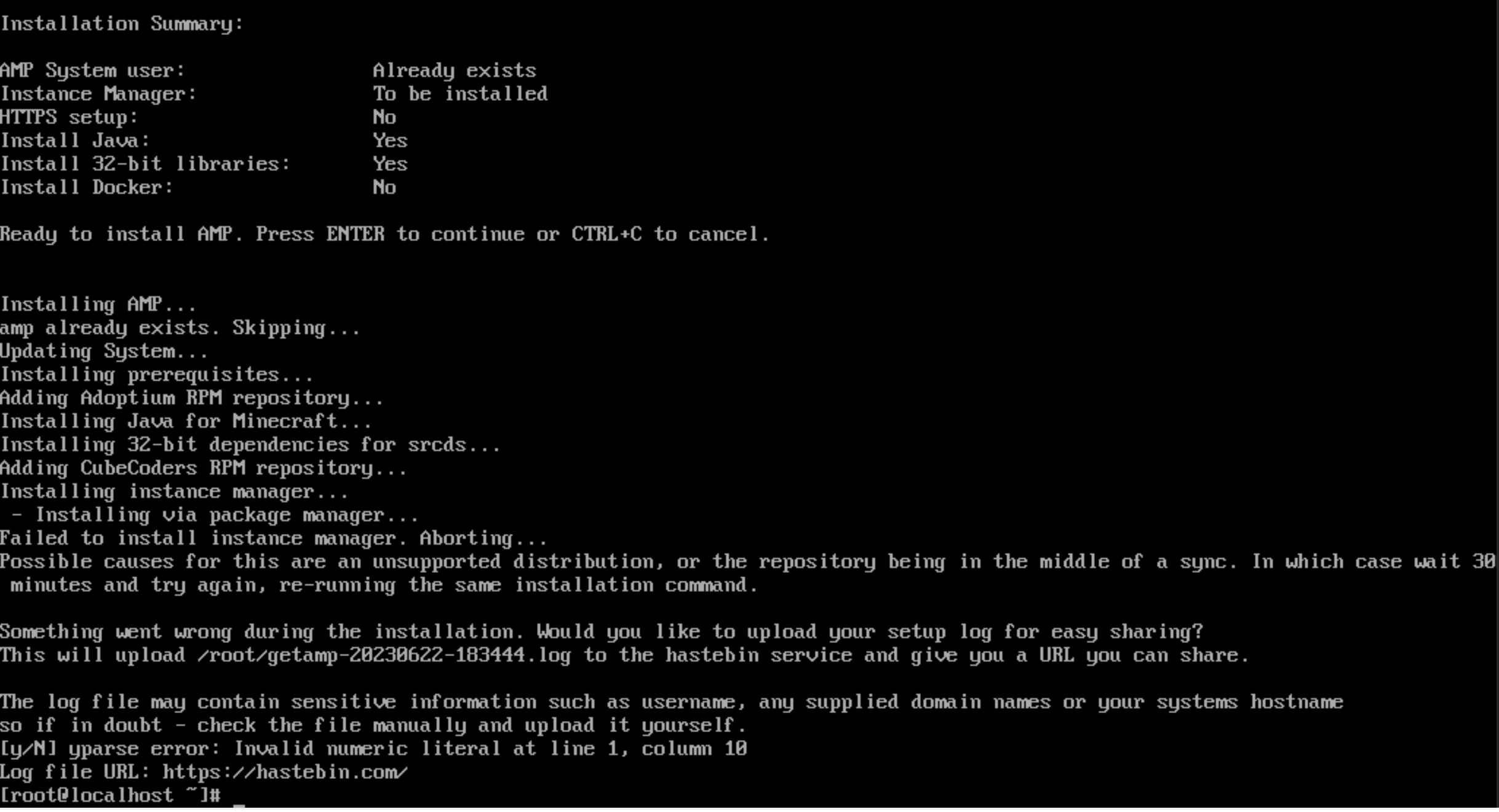

This is what happens when I try to in install. I cant even retrace the log because uploading that also fails. Why might this be happening?

Can you pastebin that log somewhere so we can look at it?

Can you show me what you’re doing and what output you get?
yes. I’m using the hosting service IONOS with a VPS running Linux Alma 9. I am running the command “bash <(wget -qO- getamp.sh)” to try and install your software (after logging in as a root user) this goes through most of the setup perfectly until I get “Failed to install instance manager. Aborting…” Even though the install partaly works, is AlmaLinux simply not supported? I could use CentOS or Rocky, but I though Alma had better support?
Alma should work fine, but you’re not answering the questions correctly.
Show me what’s happening - don’t tell me. I want to see the problem you’re having reading the log file. Without that log file I can’t tell you what to do.
Right, that doesn’t show you opening the log file which is what I need.

Apologies, I found the direct log
Remove the adoptium repo from your list of repositories and say no to java during installation.

Hi, Mike. I found this thread because I had the same issue. I followed your steps regarding removing the adoptium repo and no installing Java at install, but it still fails.
Rebooted, verified that repo is still gone and I can’t grab updates at all now.
It almost feels like the Adoptium repo is stored somewhere else too?
The repo is definitely still there - it’ll be in /etc/yum.repos.d/adoptium.repo
- remove that file.
