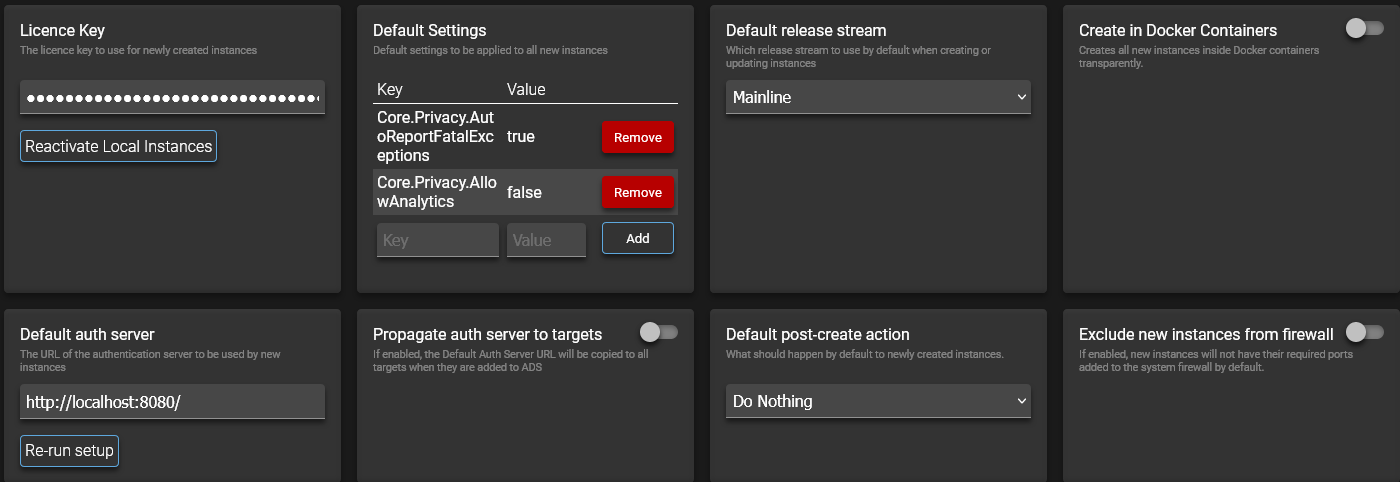

What do the logs of those new instances say? Are your new instance defaults correct?

Wipe out your BaseURL setting for the time being.
In new Instances the File Manager works now.
Non-Docker Instances failed to find Java. For some reason, despite selecting it during the AMP installation, java wasn’t installed. That was solved by manually installing “openjdk-8-jre-headless openjdk-11-jre-headless openjdk-17-jre-headless openjdk-19-jre-headless” (being most LTS and the latest java release, with 19 being the ‘default’ for now)
And Restarting or Updateing the instances did not solve it, so I really would have had to recreate all Instances
