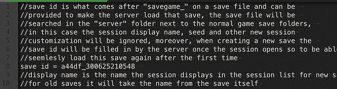

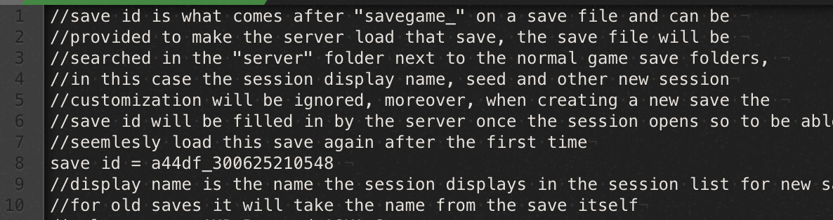

Contents of server properties.txt:

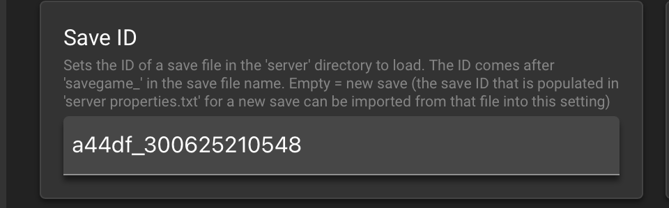

UI contents after import and refresh:
