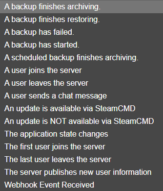

I am experiencing an issue with the Schedule Trigger functionality.
I would like to configure the server to automatically restart the instance every time the mission ends, but I cannot find an option to create such a trigger. The only options I see are the following:

The scheduler is not specific to a particular server
Have you tried -autoreload 30 -autoshutdown as additional server startup parameters?
Yes, that helped me.
i am unsure if this only shuts down the server or restarts it. i have setup a schedule: when the application state changes the app starts. is it redundant or is it just right?
AMP should restart the server if it shuts down with this method, as AMP will see it as an unmanaged shutdown and therefore try to restart it
