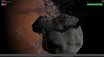

The server will appear to start, as after a minute or so it will be viewable in both the Steam game server browser and ARK’s in-game server browser, but attempting to connect to it will result in a timeout. There is also no output in AMP’s console.
I have attempted to manually connect using open IP:port in my local game’s console, but this also times out.
As a test I created another ARK instance and without changing any settings (other than ports), attempted to connect with the same results. No console, viewable in browsers, but times out.
Oddly, when shutting down either instance it does finally output something, but it is just
19:56:44: Console
Exiting...

I will note that on the configuration page, there is no text box in the RCON/Server Admin Password section:

RCON is working, seems you have a port forward/firewall issue
How is RCON working when the logs are saying connection refused? And there is nothing in the console output?
Also I am unable to connect to the server from within my own network. There is no port forwarding involved at this point, and the firewall is off on the host machine.
Because you get a response when stopping the server
Type listplayers or saveworld in the console to verify
BTW, have you referred the ASE guide in the knowledge base on this discord?
What’s the server IP binding btw?
Well I’ll be. The console is terrifyingly sparse. You’d think it’d be outputting something during startup, but you’re correct it does work.

Indeed. It is as good as it can be atm given the way ark works and amp’s console. I had to do some hacks in the template to even get that output
If amp’s log tailing can be properly implemented then it will also be possible to get the ShooterGame.log, so there will be much more displayed. Time will tell
