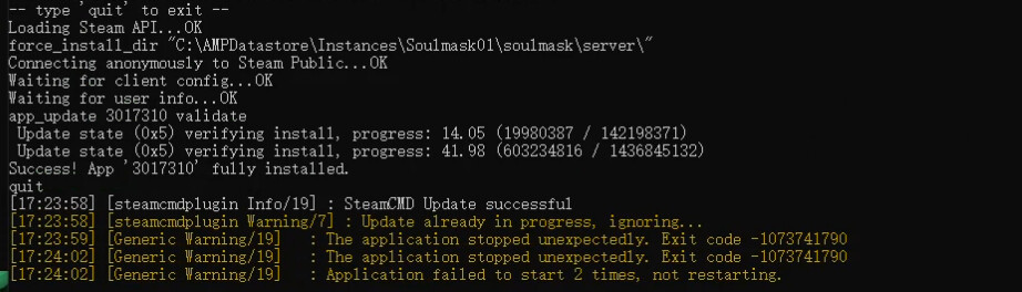

Any server won't start, But AMP seems works well
OS Name/Version: Windows 11
Product Name/Version: Currently running version 2.5.1.8 - 20240917.2
Problem Description: Any server won’t start, normally with
This task could not be completed: Starting Soulmask… - - State: 3.

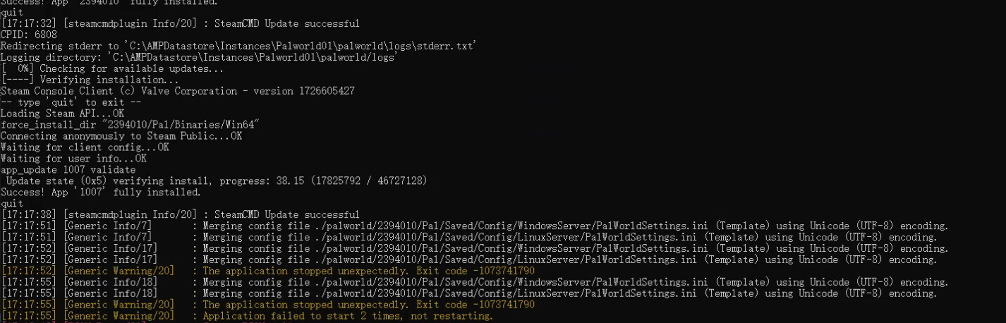

Right click the instance and View Logs. Share the latest here where you freshly started the instance and game server. No screenshot, share the file or post it on a site like Hastebin if needed.
[13:46:11] [Program Info/1] : Starting AMP version 2.5.1.8 (Callisto), built 17/09/2024 12:32
[13:46:11] [Program Info/1] : Stream: Mainline / Release - built by CUBECODERS/buildbot on CCL-DEV
[13:46:11] [Core Warning/1] : Current time zone is set to 中国标准时间 - It is recommended you switch to UTC+0 to avoid time-zone related issues
[13:46:11] [Program Info/1] : OS: Windows / x86_64
[13:46:11] [Program Info/1] : CPU: 12th Gen Intel(R) Core™ i7-12700 (12C/20T)
[13:46:11] [Program Info/1] : RAM: 32529MB
[13:46:11] [Program Info/1] : AMP Instance ID: cd89be73-bdb8-43fd-9061-49c4b584a17e
[13:46:12] [Loader Info/1] : Loaded GenericModule version 1.0.0.0 by CubeCoders Limited
[13:46:12] [Core Info/1] : Metrics publishing is enabled at udp://localhost:12820.
[13:46:12] [Loader Info/1] : Loaded FileManagerPlugin by CubeCoders Limited
[13:46:12] [Loader Info/1] : Loaded EmailSenderPlugin by CubeCoders Limited
[13:46:12] [Loader Info/1] : Loaded WebRequestPlugin by CubeCoders Limited
[13:46:12] [Loader Info/1] : Loaded LocalFileBackupPlugin by CubeCoders Limited
[13:46:12] [Loader Info/1] : Loaded CommonCorePlugin by CubeCoders Limited
[13:46:12] [Loader Info/1] : Loaded AnalyticsPlugin by CubeCoders Limited
[13:46:12] [Loader Info/1] : GenericModule requests dependency steamcmdplugin…
[13:46:12] [Loader Info/1] : Loaded steamcmdplugin by CubeCoders Limited
[13:46:12] [Loader Info/1] : GenericModule requests dependency RCONPlugin…
[13:46:12] [Loader Info/1] : Loaded RCONPlugin by CubeCoders Limited
[13:46:12] [Core Info/1] : Licence Present: AMP Advanced Edition - Lifetime Licence
[13:46:12] [FileManager Notice/1] : Using keypair with fingerprint Ta65ym4IKi++IY7JV5CaYxQ0dbO5S4JpThxsxgkHWAM=
[13:46:12] [FileManager Info/1] : SFTP Server started on 0.0.0.0:2224
[13:46:12] [Webserver Info/1] : Websockets are enabled.
[13:46:12] [Webserver Info/1] : Webserver started on http://127.0.0.1:8081
[13:46:12] [Webserver Info/12] : RouterTimer@10Hz with 2 jobs started
[13:46:12] [Core Info/5] : Checking for AMP updates…
[13:46:12] [System Info/14] : Startup mode is UpdateAndStart.
CPID: 23400
Redirecting stderr to ‘D:\AMPDatastore\Instances\Palworld01\palworld\logs\stderr.txt’
Logging directory: ‘D:\AMPDatastore\Instances\Palworld01\palworld/logs’
[ 0%] Checking for available updates…
[13:46:16] [Core Info/10] : AMP is up to date.
[----] Verifying installation…
Steam Console Client (c) Valve Corporation - version 1726605427
– type ‘quit’ to exit –
Loading Steam API…OK
force_install_dir “2394010”
Connecting anonymously to Steam Public…OK
Waiting for client config…OK
Waiting for user info…OK
app_update 2394010 -beta public validate
Update state (0x5) verifying install, progress: 34.72 (13633777 / 39266820)
Update state (0x5) verifying install, progress: 29.79 (690863117 / 2319401444)
Update state (0x5) verifying install, progress: 65.16 (1511375503 / 2319401444)
Success! App ‘2394010’ fully installed.
quit
[13:46:51] [steamcmdplugin Info/10] : SteamCMD Update successful
CPID: 21992
force_install_dir “2394010/Pal/Binaries/Win64”
[13:47:05] [Core Activity/10] : Authentication attempt for user admin from 127.0.0.1
[13:47:07] [Core Activity/21] : Authentication success
[13:47:07] [Core Warning/21] : Slow method invocation: Login took 2581ms to complete.
[13:47:07] [Core Warning/21] : Slow response: Core.Login took 2587ms to complete.
app_update 1007 validate
Update state (0x5) verifying install, progress: 31.42 (14680064 / 46727128)
Success! App ‘1007’ fully installed.
quit
[13:47:14] [steamcmdplugin Info/19] : SteamCMD Update successful
[13:47:20] [Generic Info/16] : Merging config file ./palworld/2394010/Pal/Saved/Config/WindowsServer/PalWorldSettings.ini (Template) using Unicode (UTF-8) encoding.
[13:47:20] [Generic Info/16] : Merging config file ./palworld/2394010/Pal/Saved/Config/LinuxServer/PalWorldSettings.ini (Template) using Unicode (UTF-8) encoding.
[13:47:21] [Generic Info/4] : Merging config file ./palworld/2394010/Pal/Saved/Config/WindowsServer/PalWorldSettings.ini (Template) using Unicode (UTF-8) encoding.
[13:47:21] [Generic Info/4] : Merging config file ./palworld/2394010/Pal/Saved/Config/LinuxServer/PalWorldSettings.ini (Template) using Unicode (UTF-8) encoding.
[13:47:21] [Generic Warning/19] : The application stopped unexpectedly. Exit code -1073741790
[13:47:24] [Generic Info/4] : Merging config file ./palworld/2394010/Pal/Saved/Config/WindowsServer/PalWorldSettings.ini (Template) using Unicode (UTF-8) encoding.
[13:47:24] [Generic Info/4] : Merging config file ./palworld/2394010/Pal/Saved/Config/LinuxServer/PalWorldSettings.ini (Template) using Unicode (UTF-8) encoding.
[13:47:24] [Generic Warning/19] : The application stopped unexpectedly. Exit code -1073741790
[13:47:24] [Generic Warning/19] : Application failed to start 2 times, not restarting.
[13:48:11] [RCON Warning/19] : Source RCON packet data empty. This typically means the server closed the connection.
[13:48:11] [RCON Info/19] : Source RCON disconnecting…
[13:48:12] [RCON Info/19] : Source RCON disconnected

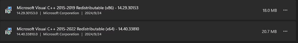

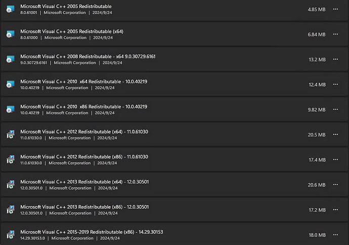

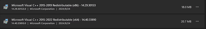

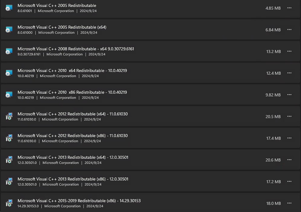

Take a screenshot of your installed C++ redistributables?
