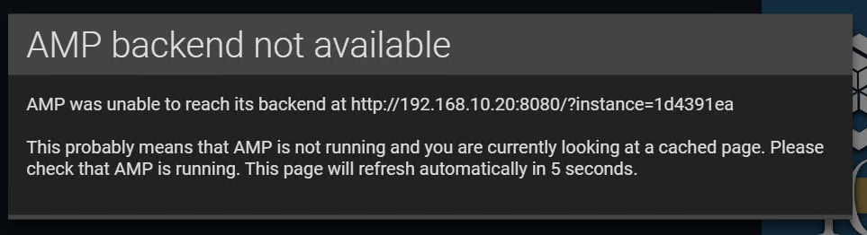

Amp worked prior to the update. I updated, which also updated some .NET libraries, and the Amp service starts and then stops. Windows error code is Event 7034, The AMP-AMPInstance1-ADS service terminated unexpectedly.
LastAmpException.txt produces the following (for the core program):

  • Tried to log into amp, shows service not running.
  • Went to services, restart service. Service starts then stops.
  • Amp core only loads when running the executable. Service spins the whole time. No other servers load.
*I have tried to change the user for the service to the local user, Daniel, but produces the same output. I have since put it back to NETWORK SERVICE.
*Ran Windows Update
*Rebooted (multiple times)
*Repaired installation
*Tried to load AMP manually. Amp finally works, but the service does not and no other servers on the core will work either.

I checked the specific instance logs. There are no entries for those.
They are still spinning and not loading.
If you right click an instance and select “Manage in new tab” - does that work?
Unfortunately, no…
Does the instance you’re trying to manage have any reference to a login attempt in its logs?
I see no reference to a login attempt inside any of the instance logs. In fact, even after the update after the permission change, the only thing that was updated, looking at the date modified values, was the AMPVersion file. The rest of them have old modified dates (3/18/2023).
