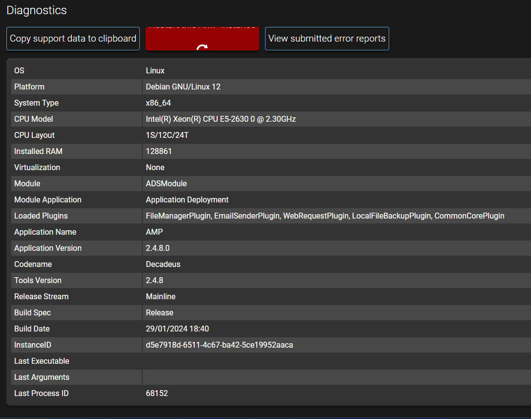

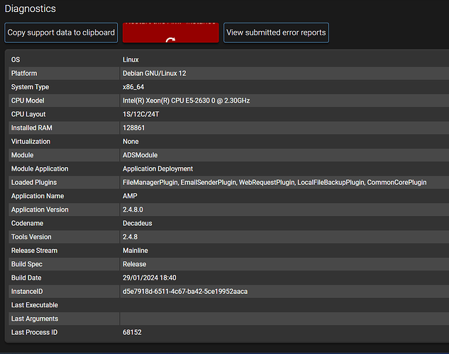

Can you show what AMP is displaying?
Is this what you meant?
So it’s just reporting the wrong number of sockets, it seems? The core and thread counts line up from what it shows there.
I thought so too but even if it was only reporting the wrong # of sockets each CPU is 12 cores so it would say 1S/24C/48T right?
That CPU has 6 cores and 12 threads. So it seems to be correct unless I’m missing something.

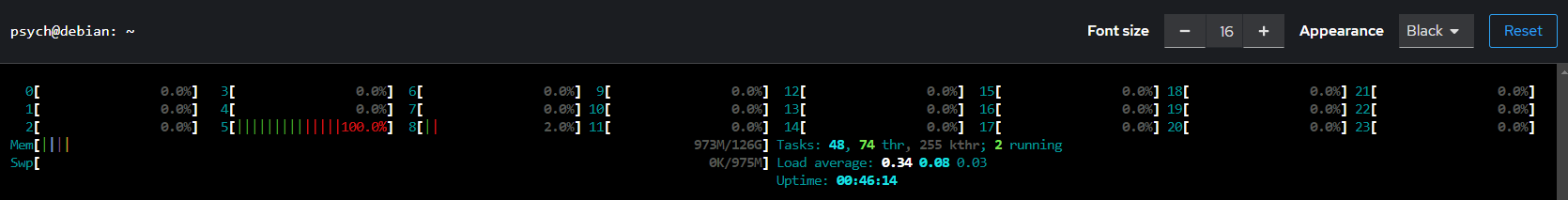

Yeah, each CPU has 12 cores… see my htop output on Debian showing each core
Tbosw are your threads. It has 6c but 12t due to hyperthreading. :slight_smile:
https://ark.intel.com/content/www/us/en/ark/products/64593/intel-xeon-processor-e5-2630-15m-cache-2-30-ghz-7-20-gt-s-intel-qpi.html
:sweat_smile: Ah, yep… sorry lol so I guess this isn’t an issue then?
Just the socket count, which is visual only thankfully.
