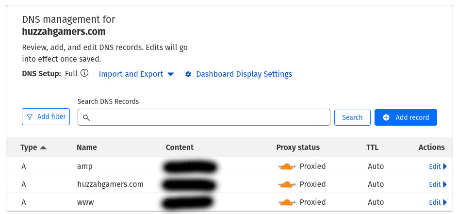

I didn’t think so either. I have it set up as the picture shows:

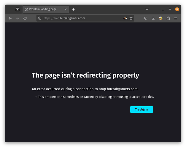

And what happens when you try to visit it?
However when I go to https://huzzahgamers.com/
I get the nginx servers default landing page.
