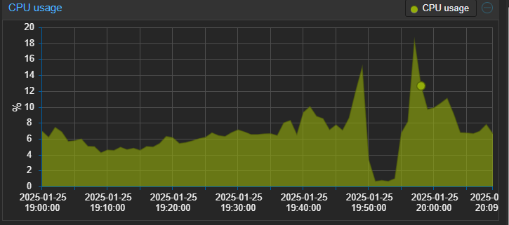

I don’t really know where to start with this but I’ll be in different games I see a massive spike in data writing to my drives and then amp shows the backend drops (“Connection to the backend…will reconnect…”) and it full hard resets all I can see are the CPU activity… you can see it dip when the crash occurs. I’m at a loss for words. Does anyone have any suggestions of where I can start looking? are there logs anywhere that can be pulled?

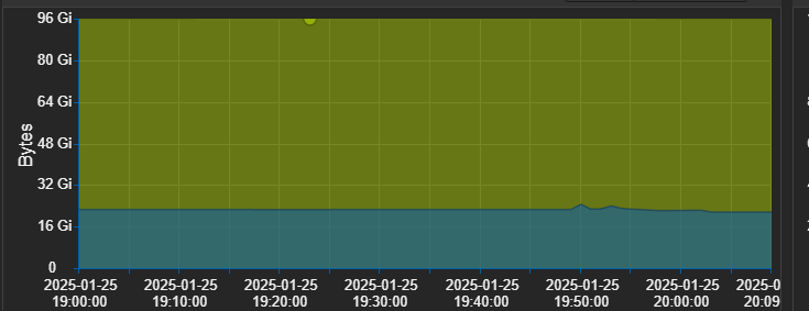

I don’t see that it’s running out of resources (RAM / CPU / storage)

One sanity check I’d recommend would be to see if you have too many backups or scheduled restarts scheduled all at the same time. Just a guess as I see the tasks service having a weird time in the syslog there.
