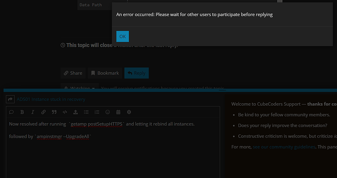

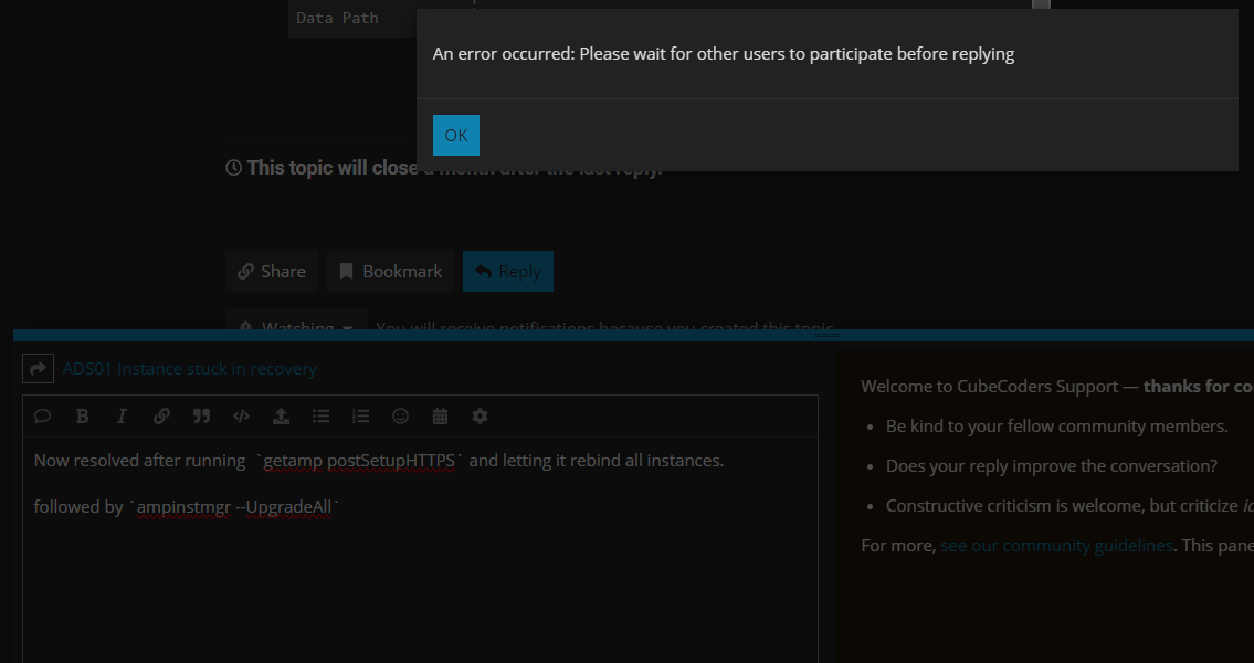

VM was moved to secondary Proxmox host, all vm hardware information such as mac addresses, processor info, memory, network IPs, etc. stayed the same.
On boot all instances load with no errors given but the web interface will not load.
The game instances (minecraft and palworld) are loading and are functional to join as a player but they can’t be managed.
Web requests get a 502 bad gateway message. Even when connecting to the local IP:Port rather than by DNS
At a bit of a loss of what else to do.
So far I have:
Rebooted of course
moved from mainline to dev branch - Didn’t fix
Reinstalled with apt - didnt fix
Reconfigured ADS01
check ngnix config, seems setup right.
