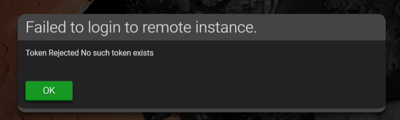

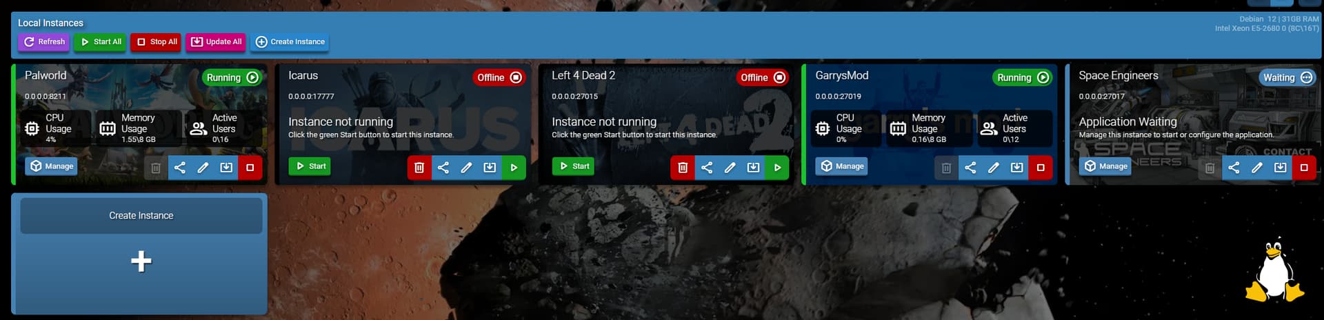

I’ve added a new instance to my, only, AMP installation. I now have 5 instances, which matches to my license. However, I have been unable to start the new instance (Space Engineers - would still prefer a Torch based version though). When I try to start it I get a message saying “Token Rejected No such token exists”. Not knowing why this is happening, and I can’t see anything in any of the logs - there is quite literally nothing beyond the request for an authentication token:
[23:58:25] [Core:admin Activity/27] : Managed remote instance SpaceEngineers01 at http://127.0.0.1:8085/
[23:58:25] [ADS:admin Activity/27] : Authentication token for admin requested by ManageInstance on behalf of admin
So I decided to take a gander at my license status - it says I have 8 out of 5 instances! But I don’t, I have only a single AMP installation and a total of 5 instances. I don’t know if this is what has caused the issue - or if there is just a problem trying to run a Space Engineers server on AMP under Linux (I have one running directly on Unraid in a Docker container so it shouldn’t be a problem).
Really hope somebody can shed some light on this as I’m stumped - with regards to both the instance not starting and the instance activation count being above what it should be.
N/A
Have tried to stop and restart the instance as well as a full reboot of the VM. Both to no avail.
Activations will sort themselves out over time, that error in the log isn’t related to your licence key at all, that’s in reference to a session token.
Try clearing your browser cache for the page, then try managing the instance.
If that doesn’t work, right click the instance and hit View Logs to see if there’s anything in there that can shed light on things. (might be as simple as reactivating the instance)

[17:43:18] [Core:admin Debug/29] : Running command line: “/bin/rm -rf – “/home/amp/.ampdata/instances/SpaceEngineers01"” from “/home/amp/.ampdata/instances/ADS01”
[17:43:18] [Core:admin Debug/29] : Working Directory: /home/amp/.ampdata/instances/ADS01
[17:43:18] [InstanceManager:admin Debug/29] : Saving instances to /home/amp/.ampdata/instances.json…
[17:43:18] [InstanceManager:admin Debug/29] : Wrote 5 instances.
[17:43:18] [Core:admin Debug/29] : Running command line: “/usr/bin/docker ps --format {{.Names}}” from “”
[17:43:23] [Core:admin Debug/29] : Task Removing Instance (Removing Space Engineers…) ended: Finished
[17:43:59] [Core Debug/46] : Running command line: “/usr/bin/docker ps --format {{.Names}}” from “”
[17:44:59] [Core Debug/41] : Running command line: “/usr/bin/docker ps --format {{.Names}}” from “”
[17:45:59] [Core Debug/41] : Running command line: “/usr/bin/docker ps --format {{.Names}}” from “”
[17:46:25] [System:admin Info/46] : Updating remote source CubeCoders/AMPTemplates
[17:46:25] [System:admin Info/46] : Updating existing remote source GitHub - CubeCoders/AMPTemplates: For the AMP community to share Generic Module templates.
[17:46:25] [ADS:admin Debug/46] : Running command line: “/usr/bin/git stash --include-untracked” from “Plugins/ADSModule/DeploymentTemplates/CubeCoders-AMPTemplates”
No local changes to save
[17:46:25] [ADS:admin Debug/46] : Running command line: “/usr/bin/git stash drop” from “Plugins/ADSModule/DeploymentTemplates/CubeCoders-AMPTemplates”
No stash entries found.
[17:46:25] [ADS:admin Debug/46] : Running command line: “/usr/bin/git pull” from “Plugins/ADSModule/DeploymentTemplates/CubeCoders-AMPTemplates”
From GitHub - CubeCoders/AMPTemplates: For the AMP community to share Generic Module templates.
3a4624f…c07124b main → origin/main
Updating 3a4624f…c07124b
Fast-forward
enshrouded.kvp | 4 +±-
1 file changed, 2 insertions(+), 2 deletions(-)
[17:46:26] [Core:admin Debug/46] : Found configuration repository at CubeCoders-AMPTemplates, ec280171-c67b-4cf8-923f-dc27fea91ee1
[17:46:26] [ADS:admin Debug/46] : StartupMode: StartApplication, OneShot
[17:46:26] [System:admin Debug/45] : Autoconfiguring instance…
[17:46:26] [InstanceManager:admin Debug/45] : Autoconfiguring instance 2c7a2824-e3b7-4458-90dc-fcdf0c816845
[17:46:26] [InstanceManager:admin Warning/45] : Non-managed instances exist, autoconfigure cannot guarantee that the configuration is valid!
[17:46:26] [InstanceManager:admin Debug/45] : Setting FileManagerPlugin.SFTP.SFTPIPBinding to 192.168.2.141
[17:46:26] [InstanceManager:admin Debug/45] : Setting GenericModule.App.ApplicationIPBinding to 192.168.2.141
[17:46:26] [InstanceManager:admin Debug/45] : Using port 8085
[17:46:26] [InstanceManager:admin Debug/45] : Using name SpaceEngineers01 (SpaceEngineers)
[17:46:26] [InstanceManager:admin Debug/45] : Setting FileManagerPlugin.SFTP.SFTPPortNumber to 2228
[17:46:26] [System:admin Debug/45] : Autoconfiguration Successful
[17:46:26] [InstanceManager:admin Debug/46] : User: amp
[17:46:26] [InstanceManager:admin Debug/46] : Home Dir: /home/amp
[17:46:26] [System:admin Debug/46] : Target path: /home/amp/.ampdata/Versions/Mainline/20241120.1/AMP_x86_64.zip
[17:46:26] [Core:admin Debug/46] : Running command line: “/usr/bin/unzip -qq -o “/home/amp/.ampdata/Versions/Mainline/20241120.1/AMP_x86_64.zip”” from “/home/amp/.ampdata/instances/SpaceEngineers01”
[17:46:30] [Core:admin Debug/45] : Task Updating remote sources (Fetching latest configurations…) ended: Finished
[17:46:31] [System:admin Debug/46] : Updating Permissions…
[17:46:31] [Core:admin Debug/46] : Running command line: “/usr/bin/chmod +x “/home/amp/.ampdata/instances/SpaceEngineers01/AMP_Linux_x86_64"” from “/home/amp/.ampdata/instances/SpaceEngineers01”
[17:46:31] [Core:admin Debug/46] : Working Directory: /home/amp/.ampdata/instances/SpaceEngineers01
[17:46:31] [System:admin Debug/46] : Building arguments list…
[17:46:31] [System:admin Debug/46] : Arguments: -firststart +Core.Webserver.Port “8085” +Core.Webserver.IPBinding “127.0.0.1” +Core.AMP.AppModule “GenericModule” +Core.AMP.InstanceID “2c7a2824-e3b7-4458-90dc-fcdf0c816845” +Core.AMP.InstanceName “SpaceEngineers01” +Core.AMP.FriendlyName “SpaceEngineers” +Core.AMP.PrimaryEndpoint “0.0.0.0:27017” +Core.AMP.PrimaryEndpointUri “steam://connect/0.0.0.0:27017” +Core.Security.MetricsHMAKKey “918646cc-4674-44fb-adbf-d4964be95869” +Core.AMP.LicenceKey “a18a91af-395a-4656-bae7-1256009eebb5”
[17:46:31] [System:admin Debug/45] : Running AMP with configuration arguments…
[17:46:31] [Core:admin Debug/45] : Running command line: “/usr/bin/id -u” from “”
[17:46:31] [Core:admin Debug/45] : Running command line: “/usr/bin/id -g” from “”
[17:46:31] [InstanceManager:admin Debug/45] : Running command line: “/usr/bin/docker run --rm -id --name AMP_SpaceEngineers01_CONFIGURE -v “/home/amp/.ampdata/instances/SpaceEngineers01”:/AMP -v “/home/amp/.ampdata/instances/SpaceEngineers01/.virtualhome”:/home/amp -e AMPUSERID=1001 -e AMPGROUPID=1001 -e AMPHOSTPLATFORM=Linux -e AMP_CONTAINER=1 -e AMP_MOUNTPOINTS=”” -e AMP_CONTAINER_DEPS=”["winehq-stable=8.0.2~bookworm-1","wine-stable=8.0.2~bookworm-1","wine-stable-amd64=8.0.2~bookworm-1","wine-stable-i386=8.0.2~bookworm-1"]" --net=host -e AMP_CONTAINER_HOST_NETWORK=1 cubecoders/ampbase:wine8 -firststart +Core.Webserver.Port "8085" +Core.Webserver.IPBinding "127.0.0.1" +Core.AMP.AppModule "GenericModule" +Core.AMP.InstanceID "2c7a2824-e3b7-4458-90dc-fcdf0c816845" +Core.AMP.InstanceName "SpaceEngineers01" +Core.AMP.FriendlyName "SpaceEngineers" +Core.AMP.PrimaryEndpoint "0.0.0.0:27017" +Core.AMP.PrimaryEndpointUri "steam://connect/0.0.0.0:27017" +Core.Security.MetricsHMAKKey "918646cc-4674-44fb-adbf-d4964be95869" +Core.AMP.LicenceKey "a18a91af-395a-4656-bae7-1256009eebb5" -loadconfig provisionargs.kvp" from “”
[17:46:36] [Core:admin Info/46] : ff9ac5f5630c5cbe67196bacb1815e6df41d389b454ef26b912bd634388e9219
[17:46:37] [Core:admin Debug/45] : Running command line: “/usr/bin/docker ps --format {{.Names}}” from “”
[17:46:37] [Core:admin Debug/45] : Running command line: “/usr/bin/chmod 700 .” from “/home/amp/.ampdata/instances/SpaceEngineers01”
[17:46:37] [Core:admin Debug/45] : Working Directory: /home/amp/.ampdata/instances/SpaceEngineers01
[17:46:37] [Core:admin Debug/45] : Task Configuring Instance (Configuring SpaceEngineers (SpaceEngineers01)…) ended: Finished
[17:46:37] [InstanceManager:admin Debug/45] : Saving instances to /home/amp/.ampdata/instances.json…
[17:46:37] [InstanceManager:admin Debug/45] : Wrote 6 instances.
[17:46:37] [System:admin Debug/45] : Post create actions: UpdateAndStartAlways (4)
[17:46:42] [Core:admin Debug/28] : Running command line: “/usr/bin/docker ps --format {{.Names}}” from “”
[17:46:42] [InstanceManager:admin Debug/28] : Running command line: “/usr/bin/docker pull cubecoders/ampbase:wine8” from “”
[17:46:45] [Core:admin Info/45] : wine8: Pulling from cubecoders/ampbase
[17:46:45] [Core:admin Info/46] : Digest: sha256:ec140ec81611b8a651fb68104d33e72c5932734b6e6b73a3a2ecd8d34a2c1f1b
[17:46:45] [Core:admin Info/46] : Status: Image is up to date for cubecoders/ampbase:wine8
[17:46:45] [Core:admin Info/46] : docker.io/cubecoders/ampbase:wine8
[17:46:45] [Core:admin Debug/28] : Running command line: “/usr/bin/id -u” from “”
[17:46:45] [Core:admin Debug/28] : Running command line: “/usr/bin/id -g” from “”
[17:46:45] [InstanceManager:admin Debug/28] : Running command line: “/usr/bin/docker run --rm -d --name AMP_SpaceEngineers01 -v “/home/amp/.ampdata/instances/SpaceEngineers01”:/AMP -v “/home/amp/.ampdata/instances/SpaceEngineers01/.virtualhome”:/home/amp -e AMPUSERID=1001 -e AMPGROUPID=1001 -e AMPHOSTPLATFORM=Linux -e AMP_CONTAINER=1 -e AMP_MOUNTPOINTS=”" -e AMP_CONTAINER_DEPS=“["winehq-stable=8.0.2~bookworm-1","wine-stable=8.0.2~bookworm-1","wine-stable-amd64=8.0.2~bookworm-1","wine-stable-i386=8.0.2~bookworm-1"]” --net=host -e AMP_CONTAINER_HOST_NETWORK=1 cubecoders/ampbase:wine8 +Core.Webserver.Port "8085" +Core.Webserver.IPBinding "127.0.0.1" +Core.AMP.InstanceID "2c7a2824-e3b7-4458-90dc-fcdf0c816845" +Core.Security.MetricsHMAKKey "918646cc-4674-44fb-adbf-d4964be95869"" from “”
[17:46:49] [Core:admin Info/45] : 737cc5fee9168d64c0f3abe451706902b8c0510a3332a5a1762d623ad92b9ac4
[17:46:51] [Core:admin Debug/28] : Running command line: “/usr/bin/docker ps --format {{.Names}}” from “”
[17:46:51] [Core:admin Debug/28] : Task Starting Instance (Starting SpaceEngineers (SpaceEngineers01)…) ended: Finished
[17:46:51] [Core:admin Debug/28] : Task Create instance (Space Engineers) ended: Finished
[17:46:56] [Core:admin Debug/46] : Running command line: “/usr/bin/docker ps --format {{.Names}}” from “”
[17:46:59] [Core Debug/28] : Running command line: “/usr/bin/docker ps --format {{.Names}}” from “”
[17:47:01] [Core:admin Debug/46] : ManageInstance called with InstanceId: 2c7a2824-e3b7-4458-90dc-fcdf0c816845 and session: admin 5279ebf4-258e-4644-8fc0-2b25285ce0da
[17:47:01] [Core:admin Debug/46] : Running command line: “/usr/bin/docker ps --format {{.Names}}” from “”
[17:47:01] [Core:admin Activity/46] : Managed remote instance SpaceEngineers01 at http://127.0.0.1:8085/
[17:47:06] [ADS:admin Activity/46] : Authentication token for admin requested by ManageInstance on behalf of admin
[17:47:06] [System:admin Warning/46] : Slow method invocation: ManageInstance took 5864ms to complete.
[17:47:06] [System:admin Warning/46] : Slow response: ADSModule.ManageInstance took 5864ms to complete.
[17:47:06] [System Error/46] : LIM - Failure to make API call to SpaceEngineers01: Connection refused (127.0.0.1:8085)
I’m about ready to just give up - I really do love AMP when it works, but it seems when it goes wrong it gets really stubborn :sob:
Right click the instance and hit View Logs, there might be more info on it’s side of things
Ok, I now very confused - but also happy.
So the fresh instance had no logs after I first created it - and had the same issue of not being able to be managed. So I just left it be after posting the above.
I looked just now (as I have only just seen your response)…and it started! The logs still are of no help, it seems it took AMP about an hour to get the instance ready, and then it started the server - without any config of course. So it is working, which makes me happy indeed - thank you for your responses.
However, I can’t help but feel that AMP should have been logging something saying what it was doing - and I still have no idea why this instance sorted itself out after an hour or so when the first one got stuck in limbo for 2 days.
Yeah that seems quite odd, I’ve personally never been able to get that issue to happen, but I’ve seen others have it at random. Next time I see someone with the issue, I’ll pass on the wise words of “give it a really long minute and see if that works”
It might be beneficial to set the Logging Level to debug inside the troublesome instances, so the next time it happens, we can see if there’s any extra errors being logged
