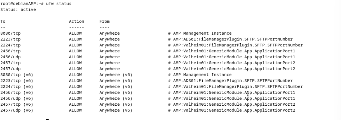

My firewall rules look like this:

root@debianAMP:~# |
Not sure why the output looks this weird or if it is related to the problem, checking ufw directly gives me this:
