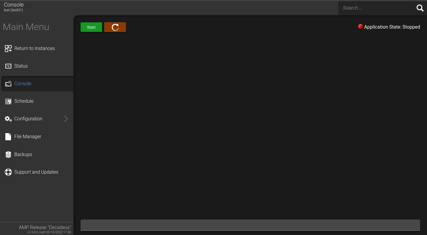

I’ve looked on the forum a couple of times but never found anything that worked
create ark instance
try to update
toggle instance on and off
Mike
October 26, 2023, 4:02pm
2
What happens when you try? What output do you get in the console?
the console does not output anything

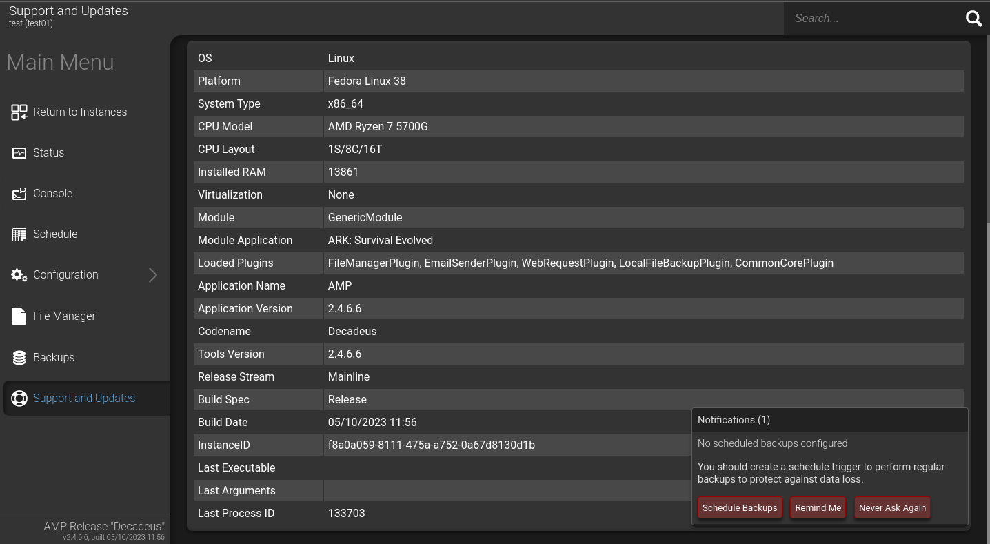

After hitting update, what does the support tab say for the most recent executable and arguments?
they’re both blank as well.

Mike
October 26, 2023, 7:56pm
12
It’s a connectivity issue - either your servers date/time is wrong, has a bad DNS setup, or some other network issue that’s preventing it from downloading update data.
