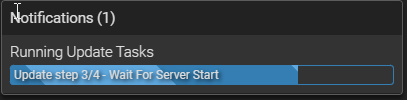

a couple of things. server is stuck on configuring, not sure on what it stops.

its possible to join the server, it even states it saved, but its a new map every time the server starts.
  • name and start server
  • i have ofc, tested to restart the server and or instance. no change
