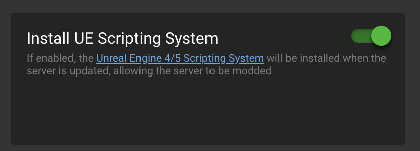

You can also disable UE4SS via the UI, under SteamCMD and Updates.
When you update the server again, UE4SS will be removed.
