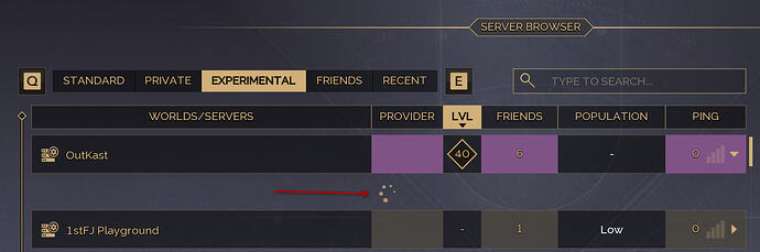

  • Attempted connection to the server in Dune Awakening, Server present and up, No Ping showing, Connected to Server, server conection said ready then “In Queue” then “Taking longer than expected” then it said “Network Error Connection timed out. P34”

Thank you, Now its loading and showing up in the server browser in game, but the Sietch is not showing up.

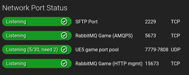

Ports are the same as before the update:
That just means you need to wait a little longer. It’ll show up after a while.
